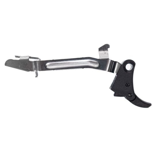

Looking for an OEM PSA Dagger trigger bar and shoe.
I’ve had my Dagger for a few years now. They used to sell them without the bar and shoe. I dropped in an OEM Glock trigger and it has consistently double fires.
I’ve even removed the Dagger slide and ran it on my OEM Gen 3 frame as well as my SCT 19 frame with the OEM Glock trigger from the Dagger and it runs without issue.
I’ve come to a conclusion it must be the cruciform engagement with the firing pin lug in conjunction with possible out of spec rails on the Dagger frame making the slide sit high because it runs just fine in the other frames.
I figured I might as well try before talking to CS and sending it back. It’s just been collecting dust in my safe.
