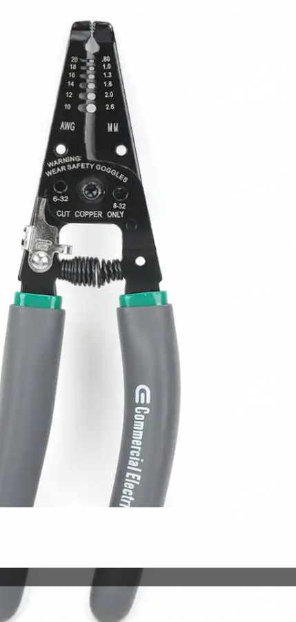

Or, you can pick up the type you need in 1/2" length and get a hardened steel screw checker plate ($20, Amazon) put the screw through it, grind or fill off the last 1/16" down to the hardened plate.
You might also try a pair of Electrician's wire strippers, most have threaded holes in them for 6-32, 8-32 and 10-32 screws, you screw the screw into the threaded size, then close the handles and it trims the screw to the length you want.

Like these from Home Depot
$14
