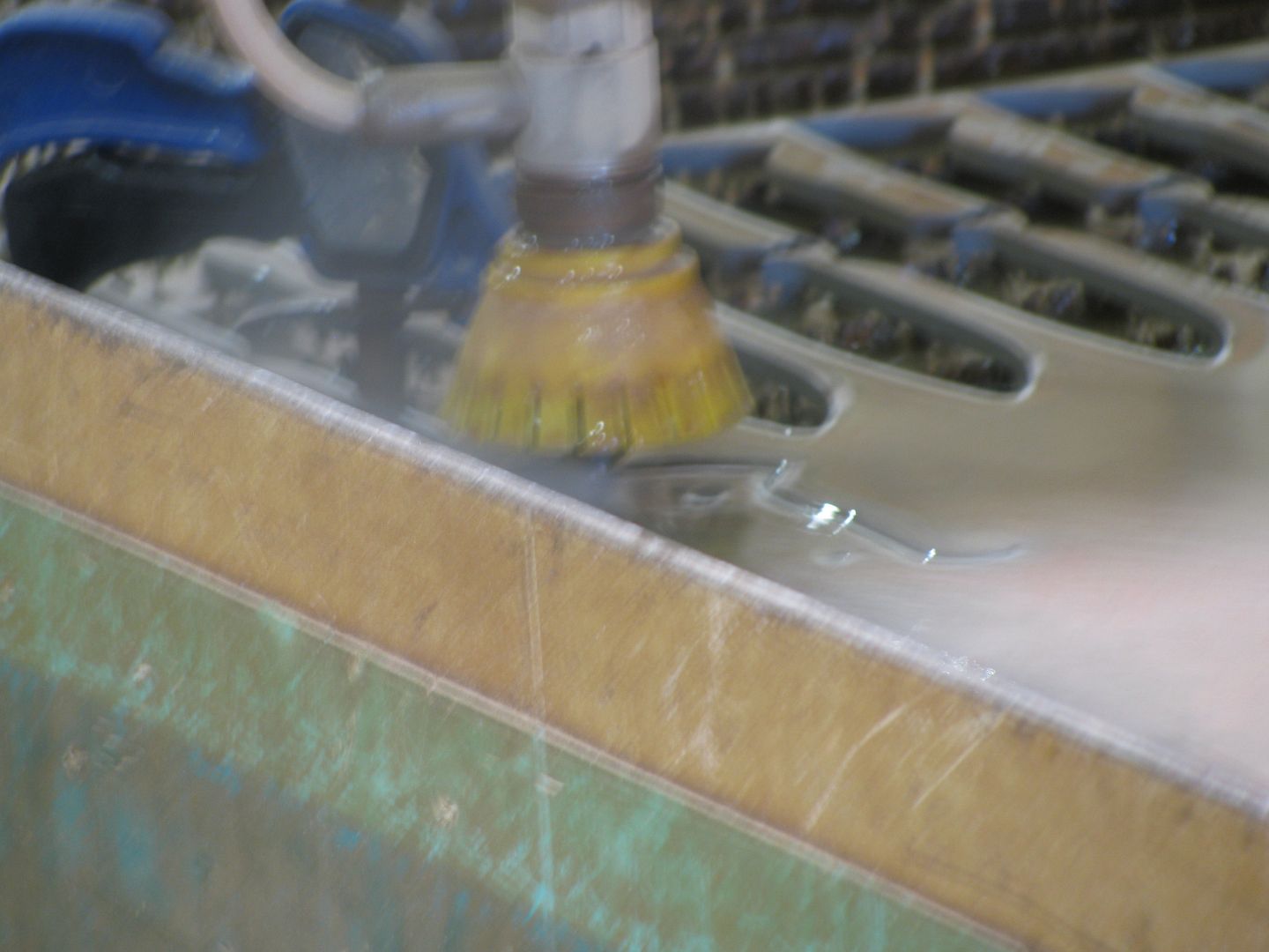

I had them delivered to a local water jet cutting service here in Vegas. Saber water jet. http://www.sabercutting.com These guys did a good job. They had a sign their from another knifemaker who used to live here. Trident knives. They used to do water jetting for him.
I didn't have the proper computer skills or software to set up my blanks for them so I just brought them in a drawing of the knives I wanted done and they did the rest.
Here is one of the guys at Saber checking out the cut.
The water jet actually cutting the steel like butter.

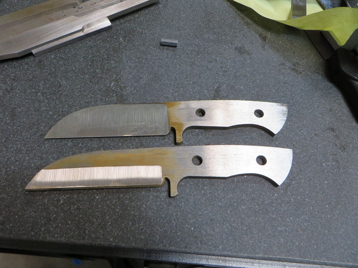

Here is a modified version that I am making for some co-workers who donated their time, labor, and some materials to do the electrical work at my shop.
First the blank was modified so only those two would have one like this, and to keep the sheep from getting scared at work.
To set up the flat grind first I hollow grind the blade to set up the angles. Then I flat grind it.
I then grind the blade on a disc sander to get the flat really flat. Then I glue a piece of sandpaper to my granite surface plant and work the flat on it getting it even flatter and removing any deep scratches before I heat treat the blade.
